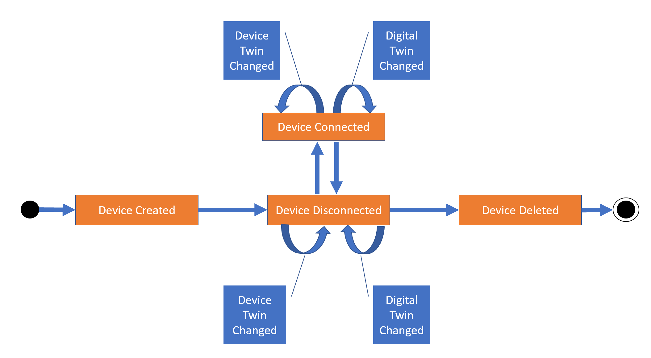

  2. Sander van de Velde | MVP 36,951 Reputation points MVP Volunteer Moderator
    2025-09-08T09:43:15.9033333+00:00
    Hello Drew Stevens,
    welcome to this moderated Azure community forum.
    It seems you are interested in the device lifecycle in the IoT Hub. Check out this blog post showing how to cope with various messages from the IoT Hub.
    There are messages for twin changes too:
    The messages are also available on an EventGrid.
    Notice that both the message body and the application properties need to be checked to get a full understanding of the changes.
