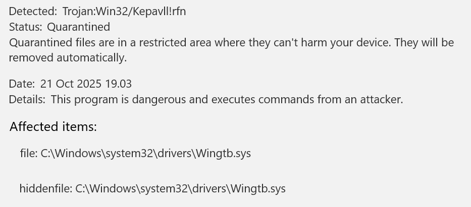

  4. Morten Irve 0 Reputation points
    2025-10-21T17:26:13.5833333+00:00
    Hi again
    My issue was a virus - Scan your server and see if you get the same - I booted into safemode - and removed it.
    Now all is good :-)User's image
