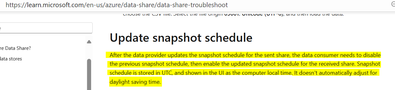

    Recreate the Schedule
    If the schedule's settings appear correct but it's still not triggering, the best solution is to recreate it. This often resolves any underlying inconsistencies.
    • Navigate to the Schedules tab for your sent share.
    • Select the current schedule and click Delete.
    • Click Add Schedule to create a new one.
    • Configure the new schedule with your desired frequency and time, being mindful of the time zone.
    Please refer these Microsoft document for more details:
    https://free.blessedness.top/en-us/azure/data-share/share-your-data?tabs=azure-portal
    https://free.blessedness.top/en-us/azure/data-share/data-share-troubleshoot
