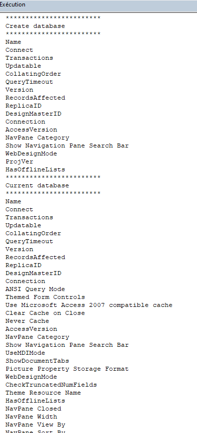

Hello,
When creating a database from VBA code with Access 2021, I noticed that some option properties were missing in my created database.
Here is some VBA code that shows this.
 Set db = DBEngine.Workspaces(0).CreateDatabase(strPathDataBaseViewRibbon & "\" & nameDataBaseViewRibbon, dbLangGeneral)
DoCmd.TransferDatabase acExport, "Microsoft Access", filePathDataBase, acForm, "ViewRibbon", "ViewRibbon", False

Here is the properties display for the created database and my current database.
We can see that the database created in VBA has much less option properties.

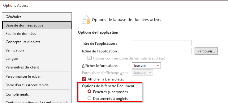

Checking the database created in VBA, I noticed in the options that the document window setting was overlapping window selection.
If I select the "tabbed documents" view and then list the option properties, I find all the properties.
How to create in VBA the database so that the document display is in the form of a tab?
The "useMDIMode" property which can position the display by tab is missing when creating the database in VBA.
db.Properties("useMDIMode") = 0 gives an error.
