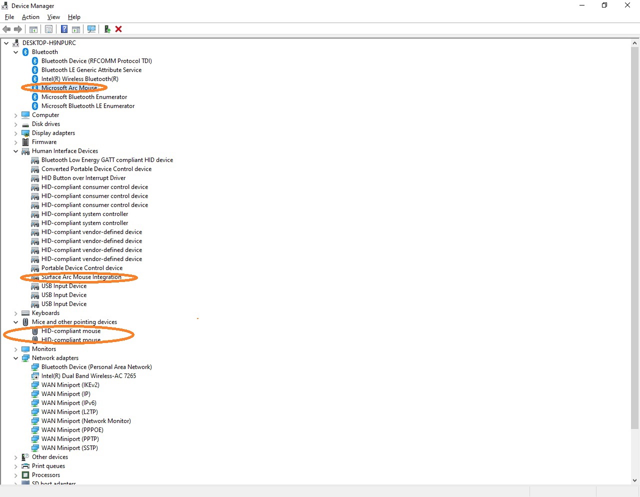

It's worth keeping in mind that even if a mouse isn't connected to the laptop, but there is a touchpad, Device Manager's "Devices by type" section under "Mice and other pointing devices" shows "HID-compliant mouse," which has Touchpad data in the registry, as shown above:

If we use the VBS code below to obtain the properties of the Win32_PointingDevice WMI class, the Touchpad is represented as a pure Mouse.

The Touchpad and Mouse have buttons. Mouse Wheel functions are implemented on the Precision Touchpad via Scroll and Scale Gestures. The MS Surface Arc Mouse and Microsoft Arc Mouse use Touch, Touch + Move (V, H) instead of buttons and wheel. At one time, in the field of mini-computers, they tried to represent any device as a file, but Microsoft Corp. went the way of different classes of devices, but the Mouse and Touchpad are also close in software and can generate identical messages and are classified as "Mice and other pointing devices."
