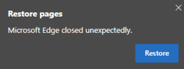

    When Edge closes unexpectedly, it shows this message to restore the previous session.
    In every case, you can restore it by pressing the shortcut Ctrl + Shift + T or on the History > Recently Closed menu.

    My Microsoft Edge has just randomly stopped doing this entirely. Now when I restart my PC I can never restore my previous session? It almost acts like the cache has been cleared everytime I restart. This "Restor Pages" doesnt even appear anymore. Its very annoying. Before it worked perfectly and would ask me to restore my session after every restart? What's going on?
