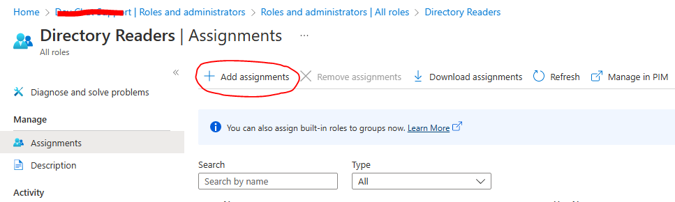

I do not have entry for my user in sys.database_principals. But I do have in sys.server_principals.
As per this I can add user to sys.database_principals using Create user command.
I am getting below error but not able to figure out how I can fix it or how I can give permission for Directory Readers?
