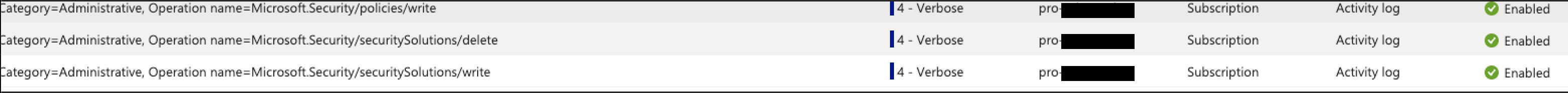

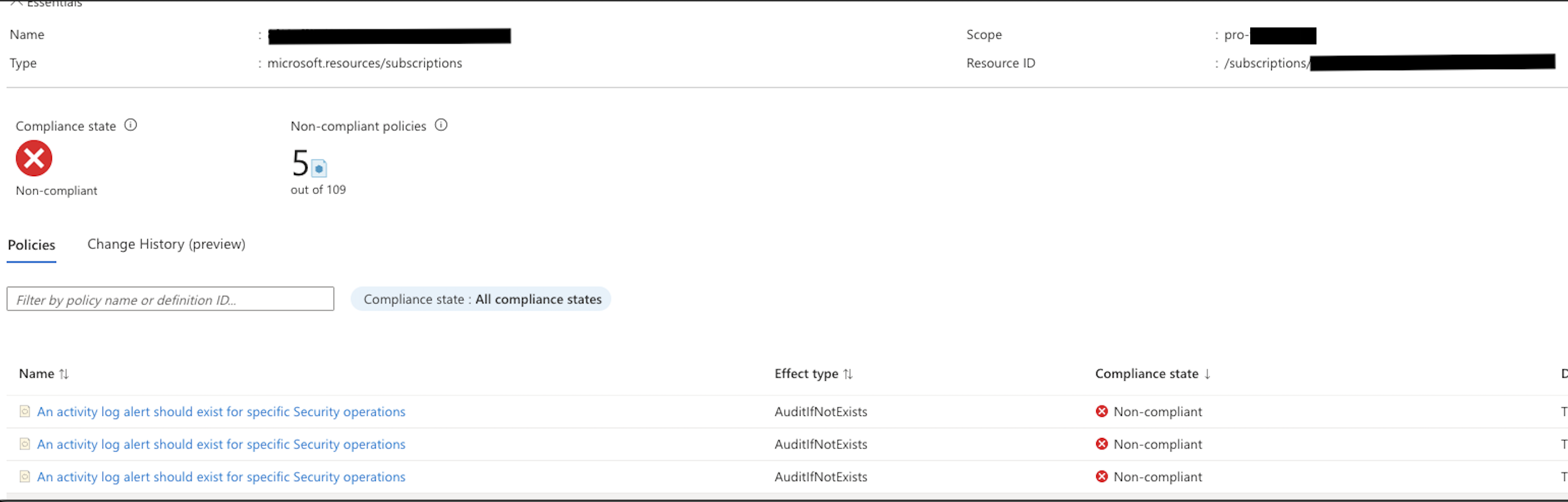

Looking at Azure policy and some benchmarks, one of the items that came up is
An activity log alert should exist for specific Security operations
I am not quite sure how to resolve it, I have got 2 subscriptions and the policy is compliant on one of the subscriptions but not the other, however in order to fix it, I would like to understand what needs to be done.

    The compliance for this policy is based on the following policy definition - An activity log alert should exist for specific Security operation. When you click this link, it takes you to the definition page of this policy which is a built-in policy.
    It seems that you have assigned this policy to your subscription or that you have assigned an initiative containing this policy (an initiative is a collection of policies). The list of built-in initiatives and policies is available here - Azure Policy Regulatory Compliance controls for Azure Monitor.
    In your subscription, where this policy is shown as non-compliant, you will have to create "Activity Log Alert Rule" for specific operations. To create it,
    1. Go to "Monitor" in Azure portal --> Alerts
    2. Select "+Create" --> "Alert rule" from this page's options.
    3. "Select Scope" as the subscription (select subscription and select "Apply" or "Done")
    4. Under conditions, click "See all Signals" and search for "Update security policy"
    5. Follow further steps to create alert.
    You may have to follow this step for the following 2 categories as well:
    • Create or Update Security Solutions (Security Solutions)
    • Delete Security Solutions (Security Solutions)
    I would suggest checking the activity log alert rule available in your compliant subscription and create the activity log alert for the ones for which it is available to ensure compliance.
