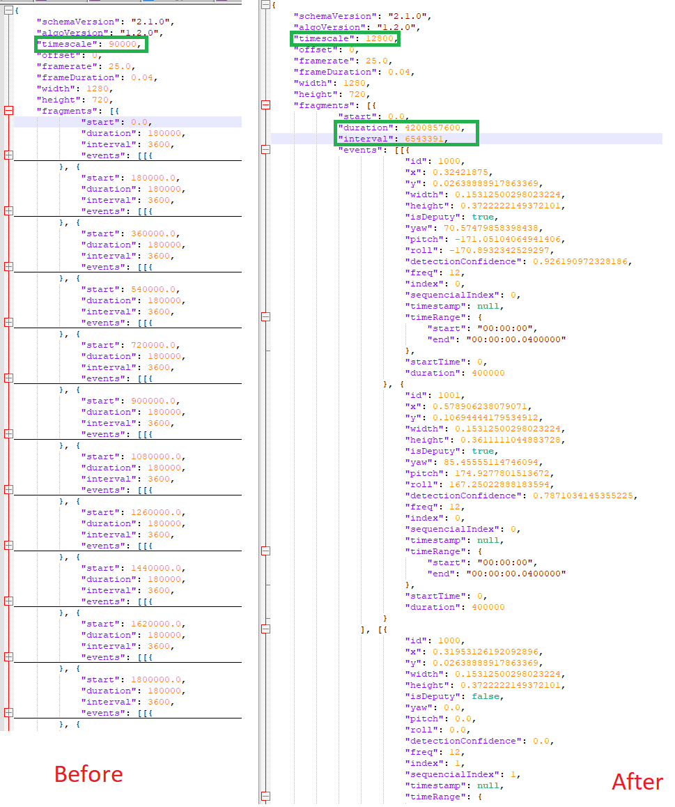

Hi, We migrated to Video Indexer a few months ago from Media Services, and things worked fine. We've recently re-tested the same video and it appears that where we used to get a large list of fragments with events in each fragment, with an set interval between each fragment. We now just get one large fragment with a long list of events in it. Has this changed recently?
I was expecting the way the algo worked to stay consistent and return the same JSON as it has done previously:
Before and After

    Hello Chris Pressley,
    I understand that your Azure Video Indexer Insights Changed.
    If you must have the exact old JSON structure (not just fragments at a given interval), follow this reproducible diagnostic flow:
    1. Fetch canonical insights using the Get Video Index (Videos/{videoId}/Index) API and save it. Microsoft Learn
    2. Fetch faces artifact via Get Video Artifact Download Url?type=faces and save it. Microsoft Learn
    3. Record: the exact videoId, the UTC timestamps when each indexing job ran, indexingPreset used on upload (if any), and your account location and accountId. (These are the fields MS support will ask for.) Microsoft Learn
    4. Re-index the video explicitly setting indexingPreset to Standard or Advanced (match previous environment or try both) and re-download artifacts. Example upload query param: &indexingPreset=Advanced (the API sample uses indexingPreset=Default in docs; other valid settings correspond to Basic/Standard/Advanced in the Indexing Configuration doc). Compare outputs. api-portal.videoindexer.ai+1
    5. If reindexing with the same preset doesn’t restore the old format, open a Microsoft support ticket
    Alternatively, if your old code expects N fragments at a fixed interval, but the artifact now contains one big fragment with many events, you can recreate fragments by bucketing events into fixed time slices.
